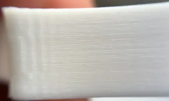

Ghosting is an artefact in the print due to the vibrations in the printer that are induced by rapid changes of direction. It is important not to confuse them with inherent vibrations in the printer due for example to the belts being loose or the bearings not being in perfect order.
The good news is that it is relatively easy to tell them apart: ghosting (also known as "ringing" or "ripples" or "waves" or a number of other names...) is always downstream of a change of direction, and fades rapidly.
ghosting

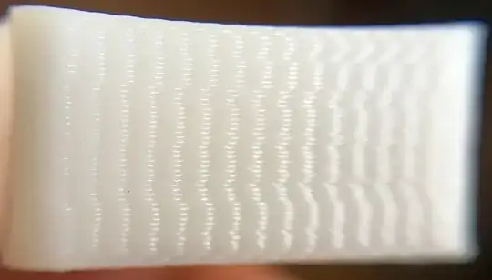

Inherent vibrations - on the other hand - tend to be consistently present when printing along a given direction, and do not fade.
inherent vibrations
Mechanically, ghosting works like this:
  1. The moving part is travelling along - for example - the x-axis, when suddenly the direction of movement becomes the y-axis.
  2. At that moment, the stepper motor of the x-axis stop rotating, but the momentum of the moving part stretches the belt even so slightly past the intended stop point.
  3. At this moment the belt becomes like a rubber bend / spring, absorbs the kinetic energy of the moving mass and releases it by "throwing" it past the intended stop point in the other direction.
  4. This keeps on repeating a number of times, but at each pass, some of the energy is dissipated, and the moving mass moves less end less away from the ideal stopping point.
  5. While all of the above is happening, the object has also begun to move along the y-axis, so the extruded plastic looks "weavey" along the y-axis.
