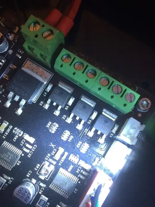

Damaged transistor associated with E0 (3rd one on the right)
I’ve damaged the transistor associated with E0 (3rd one on the right) and so that means I need to avoid that. I’ve decided to switch to E1 for the extruder but I have a feeling I need to go in the firmware or Repetier host and manipulate that.

The third one, Switch the transistor from E1 to E0 (your Q2 for Q1) or Q3 if you are not using the FAN output.
