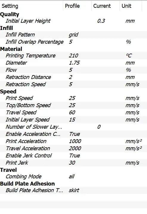

Here is the print profile:
Screenshot of Print Profile

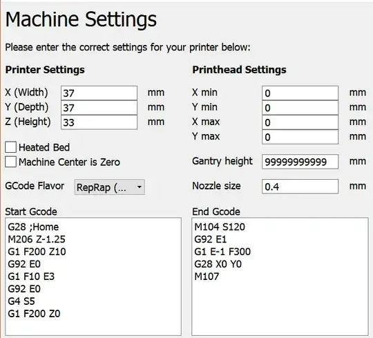

Here are the Machine settings:
Screenshot of Machine settings

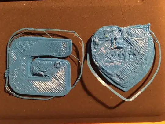

This is a photo of two failed prints. On the left is a G and on the right is a heart.
Photo of two failed prints

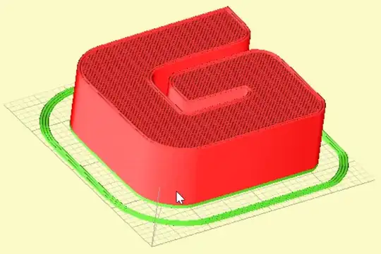

This is what it was the G was meant to look like:
Pronterface G

    • Did you set up your printer correct in Cura (Preferences -> Printers -> Machine Settings)? Material Diameter, Nozzle size and G-Code flavour are correct?
