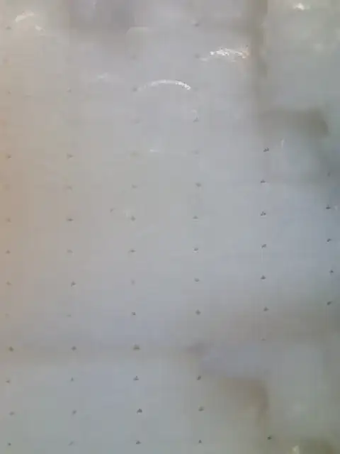

The main issue with very narrow extrusion widths (less than the nozzle size) is that you get really poor "nozzle squash." The plastic isn't pressed down very hard as it's extruded. That causes poor layer bonding and weaker prints.
The flow of molten plastic coming out of the nozzle must be drawn down by tension in order to end up smaller than the nozzle opening, and that drawing effect makes it difficult to get good contact with the previous layer. So you end up with a "stack of logs" structure kind of like this:
0.4mm wide by 0.4mm tall strands through a 0.4mm nozzle (This photo actually shows layer height = extrusion width = nozzle size, which is another no-no, but the end result is similar.)
What you want instead is something very "mashed together" and strong like this: 0.4mm wide by 0.4mm tall strands through a 0.4mm nozzle
