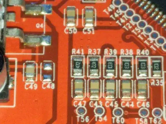

I accidentally let the print head of my Anet A8 crash into one of 2 clips that are holding a glass sheet onto the hot bed, and suddenly the screen went blank and the printer rebooted, then it started reading 739°C from the extruder thermistor. I tried changing the thermistor, but that didn't have any effect. Also tried swapping the extruder thermistor with the hot bed thermistor, but there was no effect on both. I checked both the connector and the socket of the thermistor for shorts but found none. Any ideas about the reason this is happening?

I measured R41 located next to the hotend thermistor header R41 location and found out it has a resistance of 1.5kΩ, while it should have a resistance of 4.7kΩ, so I suspect this is the main reason behind this high reading. Now the only thing left to figure out is how the resistance of this resistor changed.
I was able to figure out which resistor to measure with the help of this schematic: https://github.com/ralf-e/ANET-3D-Board-V1.0/blob/master/ANET3D_Board_Schematic.png
EDIT 3 I tested T56 (located near the headers) and T55 (located near the ATMEGA1284P) for continuity, and found out there's no connection between those, while they should be connected according to the schematics. I also checked the hotbed's terminals T54 and T53 and found continuity between them, which means the problem might be in the trace between the thermistor header and input pin of the ATMEGA chip (this trace is VERY thin, so any overcurrent might cut it), or any component in this trace.

I had the same issue. Hot-end temperature reading stuck at 209 degrees even with hot-end thermistor disconnected or swapped with bed thermistor on the Anet A8 mainboard.
After ordering and swapping the AtMega1284p (using jtagice3 and hot-air soldering station) and the 4.7 Kohm resistor (which measured 2.06Kohm on the board and 4.7kohm off the board) to no avail, the only component left in the circuit that could cause the failure was the capacitor.
Swapping the capacitor C47 fixed the stuck reading for me. I used a 10uF instead of a 15uF capacitor as indicated in the schematic. I do not believe it makes much of a difference, and they are much more common. Make sure the capacitor can withstand at least 10V, but I got a 30V one, because the price was similar.
To any body that runs into this issue, before spending time and money swapping components like I did, measure the voltage of the node between R41 and C47 with respect to ground. This is labeled T56 or test point 56. Compare this voltage to T54, T60, T58, and T62 where similar circuits are placed. You should get a voltage of around 5V ( the pull-up voltage) in the functioning circuits, since we are talking about DC voltage, the capacitor should charge up nearly instantly when the the board is powered, and behave as an open-circuit.
In my case, C47 was almost in full short-circuit, and I read a low voltage on T56 ( ~0.5v).
Since the capacitor was in a low impedance failure mode, the 5V supply voltage of the voltage divider circuit was not enough to power it, hence the fixed temperature readings of the hot-end thermistor ADC channel regardless of the thermistor being connected or not.
Good luck!
You can't measure the resistance of a resistor in circuit - the resistance probably appears to be lower to your multimeter because of some other circuit elements. There's also no reasonable explanation for how a 4.7k resistor could suddenly turn into a 1.5k one. It's highly unlikely this resistor is the cause of your issues.
It is more likely something else is damaged, likely the AtMega1284p microcontroller itself. When your extruder touched the bed clip, perhaps the 12V from the bed shorted through the clip and to the extruder? I would guess that the 12V shorted itself to the thermistor input, which subsequently blew the ESD protection diode on that input. This might explain the high reading and the low apparent resistance of R41.
