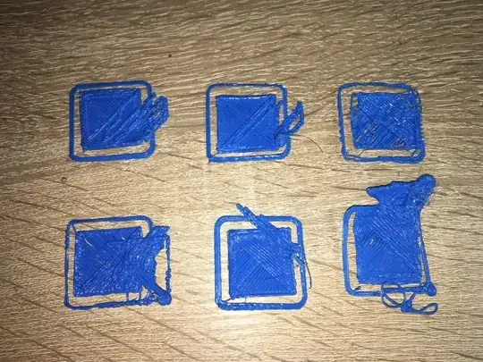

Below is an image containing the 6 most recent prints in which I played around with the different factors mentioned above. The top middle one is the most recent one. The object i am trying to print is a simple cuboid. The 6 most recent prints in which I played around with the different factors mentioned above the top middle one is the most recent one

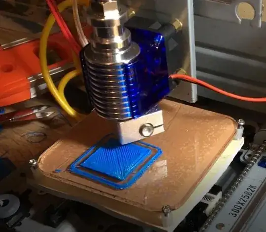

This is what the first layer of my most recent print looked like. There is some kind of gap in the middle for some reason, but I don't think that is the source of the error. The print appears to have adhered well, at this point and it is relatively flat. first layer of print

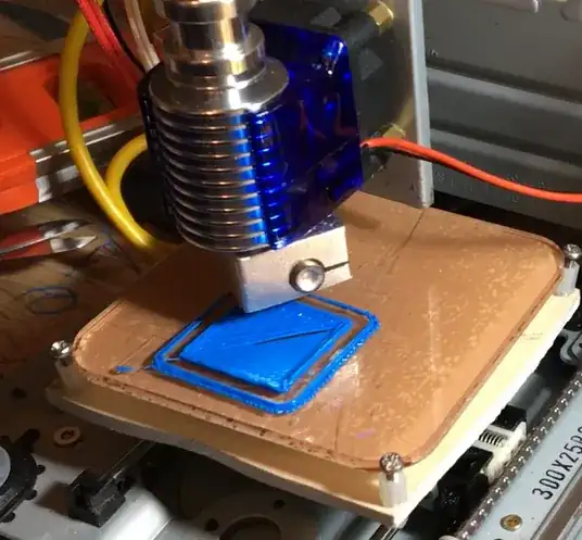

This is what the second layer of the print looked like, notice how the lines are wobbly and not very neat. There is also a small area of higher height in the bottom left corner which inevitably causes the nozzle to get stuck. enter image description here

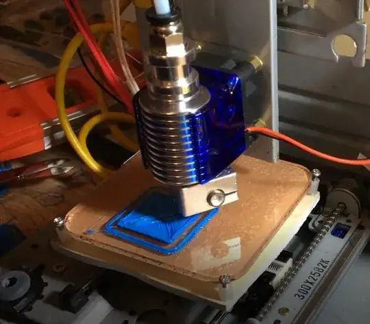

This is the print after the nozzle hit the now cooled down blob, missed some steps and then was misaligned. It then goes on to print the next layer in the wrong place and gets stuck very badly. enter image description here
