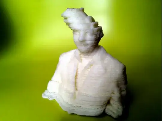

Occasionally, while printing, my y axis will slip and the layer will, from that point forward, be shifted, ruining the print.
What might be the causes of an axis slipping? I have tried cooling the motor which seemed to have been getting warm, and the belts are not too tight.
This does not happen with every print, and seems to be an intermittent problem.
My printer is a MendelMax RepRap, and the y axis is my moving bed.

Shifted layer 2
(source: all3dp.com)
Your printer is skipping steps in the y-direction. This can have several causes. Take a look into Shifted layer guide on RapRap.org which lists 29 possible problems that can cause this issue and how to fix them.
