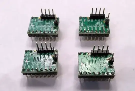

Trinamic drivers
Most of the noise is created in motors.
Definitely switch to Trinamic stepper motor drivers. I have upgraded from Prusa i3 mk2 to mk3 last weekend and the noise reduction is significant, my estimate is 80-90%.
Take a look on this awesome blog post and video from Thomas Salanderer about the driver. Other good post is on instructables.
I would not suggest soldering unless you are a skilled hacker. Better option is switch to different board.

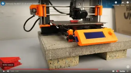

Use a concrete paver as described in this youtube CNC Kitchen channel. It reduces noise by 20dB (not if you use trinamic drivers).

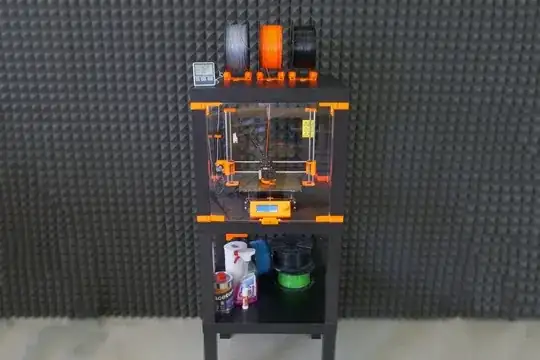

Enclosure
An enclosure should also help to reduce noise.
How to build enclosure from Ikea table: https://www.prusaprinters.org/cheap-simple-3d-printer-enclosure/

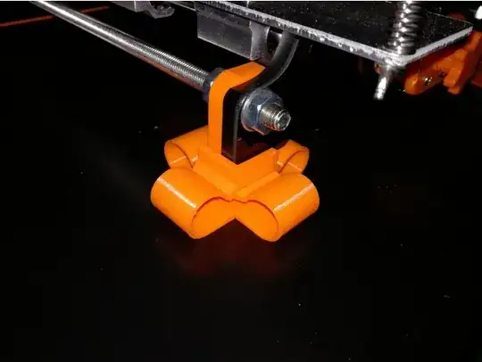

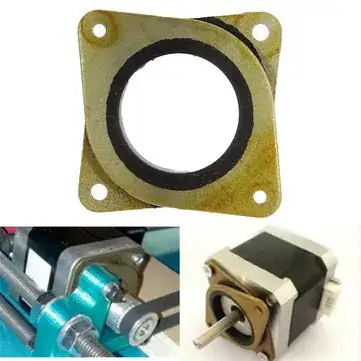

Dampers
Dampers help you reduce noise. There are two types of dampers:
Video about silencing the Prusa i3 MK2 & Horrible Vibrations:

I use a paving block with rubber feet underneath it on the floor. It is very effective: The 3D printer is sitting right beside a door, and you can't hear it printing from the other side of the door.
The low-frequency sounds are definitely absorbed by the paving block. What you can hear now are only the hissing sounds, when the extruder glides along the rods.
I wouldn't put the paving block on a table, though, or anything elevated, since that will only magnify the lever effect of the table legs and exacerbate vibrations.

Change DRV8825 / A49nn series on board stepper driver with Trinamics TM2100 ( in silentChop mode) will make your step motors almost silent. They are outstanding.
But there are couple of disadvantages:
  • There is chance of losing steps in slientChop (Would not effect print quality in my experience)
  • TMC2100 is 5-6x times more expensive than DRV8825
  • Require soldering and electronic knowledge
  • TMC2100 runs hotter

I have an Anet A8 and these vibration dampers do a great job:
Thingiverse: Vibration Damper for Anet A8

If you hear it from a floor to the other the only thing to change is the base of the printer. Nothing else matters.
CNC Kitchen performed measurements especially to avoid noise being transferred to other rooms, the result is that placing the printer not on elastic feet, but on a single slab of concrete which is placed on top of foam is the best solution and reduces the noise significantly.
