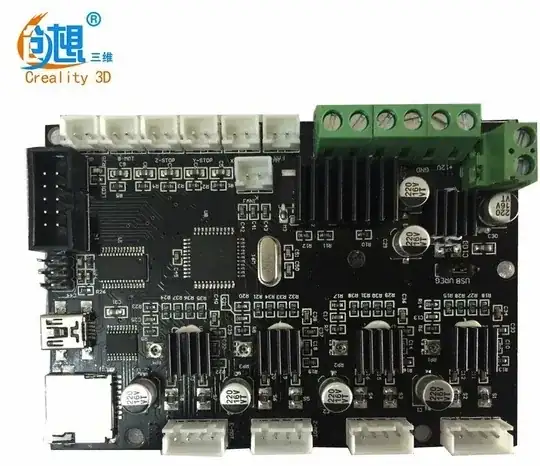

  • Controller board v1.1.2 (or v1.1.3 with additional filter capacitor) which uses CR-10 firmware. These have a small Atmel ATmega1284P chip, and one Z-axis stepper connector;

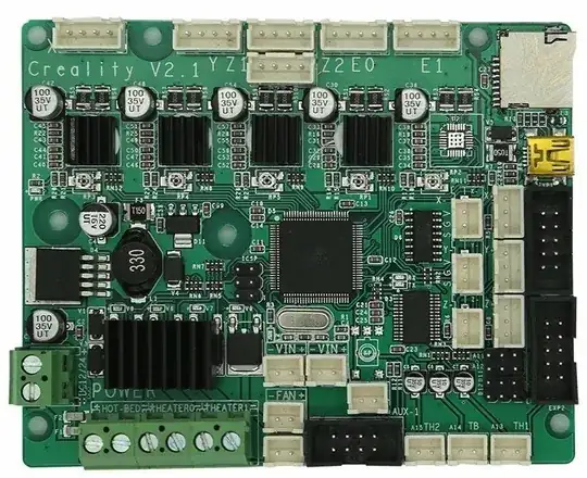

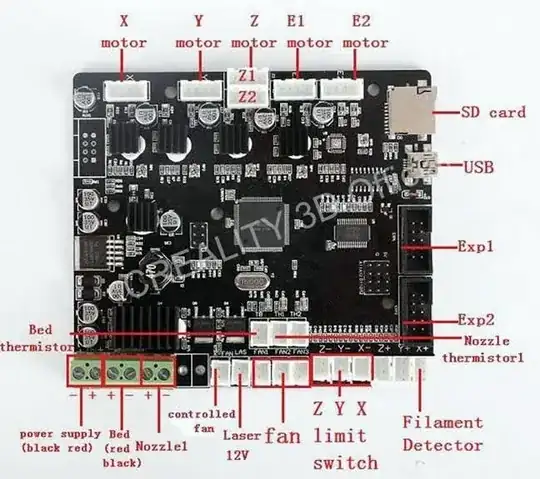

It is the v2.x (CR-10S) board that has the filament detector, which uses the X+ endstop connector:
v2.x CR-10S controller board

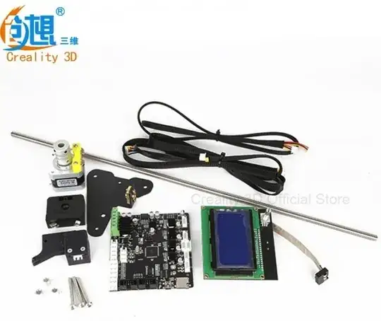

Separate upgrade
With respect to the first question, you would be best off contacting Creality directly, via their customer support, to see if the sensor is available separately. This would probably make for the least painful method of implementing the filament sensor.
Alternatively, there is this kit, Creality CR-10S Upgrade Kit, for $120:
Best Upgrade Kit for your Creality CR-10 3D Printer contains Dual Z axis for Stability in 3D Prints & Filament Monitoring Alarm Protection (Sensor) which alerts you when the filament has ran out or broken for Smart 3D Printing
There seems to be a dual-Z option, for an extra $80

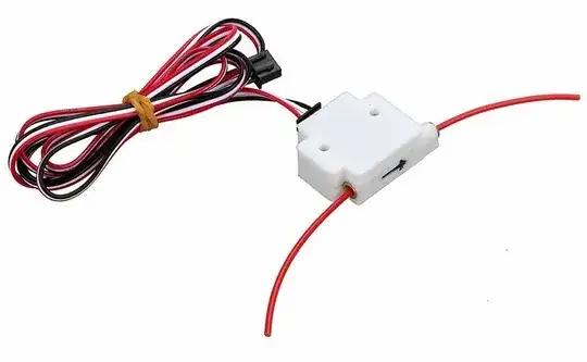

For the second question, the XCSOURCE 1.75mm 3D Printer Filament Detection Sensor Module Filament Run Out Pause Monitor for 3D Printer DIY Kit TE720,
Filament detector
the instructions state that it is designed principally for Lerdge control boards:
Instruction:
  1. When you are using a Lerdge brand motherboard: The green light on the motherboard will turn off when the filament runs out, the motherboard will stop printing until you supplement the filament and continue printing. (Please connect to the M-sensor Interface)
  2. When you are using other brand motherboard: The Detection Module uses the level transition detection method. While there still have filament in the module, the detection port shows as high level; when there is no filament in the module, the detection port will transform to low level as "Filament Run Out Command" which will stop the printing, so you will have time to supplement the filament and continue printing.
So, it is not particularly clear as to whether it will work with your board - for it to do so, your board would need to have:
  • A compatible input (i.e. X+ endstop);
  • The compatible firmware (CR-10S), and;
  • Use compatible logic levels (i.e. active LOW to shutdown printing).
If not, then given point #2, it would appear to require additional external logic, or microcontroller, to sense the transition to LOW and then shutdown the printer.
For example, this chap on Thingiverse, Cr-10 Filament Sensor Bracket & Tutorial, states that they bought a sensor off eBay, that looks similar, and they provide a printable mount and instructions on how to use it with a CR-10. However, it is not a standalone affair as shown in the CR-10 S4 - because an additional Raspberry Pi and OctoPrint is required.
To use this particular sensor with your board, you would need to:
  1. See if which controller board you have - either the CR-10 or the CR-10S compatible board (see Board Comparison above). If it is the CR-10S therefore it has the compatible input (X+ endstop), and firmware, needed for the filament sensor,
  2. Enable the use of the sensor, if necessary, in the firmware (either by the UI if possible or uploading new firmware) and;
  3. Check whether the CR-10 controller board uses active LOW to detect a lack of filament (or again, this may be a UI, or firmware, setting)
    You could test this last point yourself, by applying a LOW level voltage (i.e. grounding) to X+ endstop input on the control board (after checking the UI/firmware for appropriate settings), and see if that halts/pauses the print. If not, try a HIGH level (5 V). If it is active HIGH then you simply need to use an inverter (i.e. 4069), between the sensor and the X+ endstop connector.

There are two principle board options, v1.x and v2.x, the latter has dual Z stepper motor connectors and the former does not .For example:
Version 1.x, for CR-10 firmware - Motherboard Controller DIY Creality 3D® CR-10 / CR-10S 3D Printer CR-10 Upgrade Control Board12V (CR-10S Mainboard)
v1.x Controller with single Z connector
Version 2.x (2.1 in this case) with Dual Z stepper connectors, for CR-10S firmware - Luxnwatts CR-10S Mainboard Replacement Controller Board Upgrade V2.1 Motherboard For Creality S4 S5 3D Printer
v2.x Controller with dual Z connector
