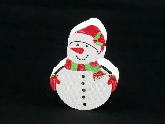

What you ask may be easier than you think. The slicing software is unimportant, generally speaking. Consider especially that your requirements fit the solution spot on.
Take a look at this thingiverse snowman.
colorful Snowman
Each of the colors is a separate model. Each of the colors is only one layer thick (0.200 mm). Each of the colors is placed with zero overlap to the adjacent colors, as the extrusion multiplier will allow enough "squish" to cause a bond to its neighbor.
You would create a model with the necessary shape for your lettering and insert the appropriate color for them. Print that model but leave it on the bed. If the bed is heated, all the better, but don't let it cool to the point of release. If it's not heated, the adhesive should hold it until project completion.
For the main background color, your model would be normal but with a single layer subtracted at the base. The subtraction would have to be the shape of the lettering. Consider that you're creating indented or recessed lettering. Use appropriate modeling techniques to perform this action.
Keep in mind that you'll want the lettering to be mirrored, as you're printing it "upside down" on the build plate.
Swap out the filament to the main color and print.
You are color limited only by your determination and patience, as you have to swap out filament and also have to create appropriate models with recesses to take the first layer, of which you'll also have to create models.
I've created at least one of the snowman pictured and it came out quite good. The layman will not be as astonished as someone familiar with 3D modeling and printing, however. You get a better appreciation when you know what goes into the project to get this result.
