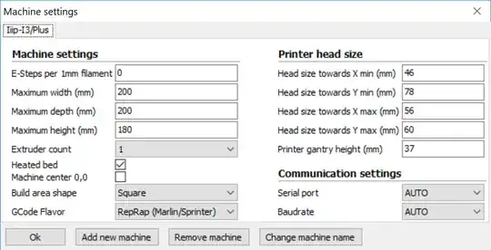

I want to print multiple objects in a single G-code file on my Maker Select Plus 3D Printer.
On the Cura "Machine>Machine Settings..." menu, what are the correct settings for "Printer head size" in the upper right quadrant?
My best guess is below:
Machine Settings Dialog
Note 1: I'm particularly concerned that I got the min and max directions correct. For instance, I just swapped my Y min and Y max values because when I tried them the other way, the print head impacted the first object when printing the second.
Note 1.5: I added 10 mm to my settings because I was concerned that Cura wasn't accounting for the width of the raft that I usually use when I print.
Note 2: From what I've read online before posting this question, this printer may be physically the same as the WanHao Duplicator i3.

TL;DR
The settings that you seem to need can be found here: Print One At a time settings? CURA:
You actually can!
Providing that none of your object is too tall (taller than the Gantry clearance). Also the objects cannot be too close from each other (when you activate the option and move objects on the bed, you see a gray box around them showing this limit).
The reason you cannot use it at the moment is probably because you didn't filled the printer head size parameters (Menu "Machine -> Machine Settings..."). You will have to measure them, but on mine (Australian clone of the i3) I use those values and it works fine:
  • Head size toward X min: 30
  • Head size toward Y min: 70
  • Head size toward X max: 60
  • Head size toward Y max: 50
  • Printer gantry height: 35
Those are "conservative" values (a little bigger than the actual values). It means I'm losing a little bed space, but I prefer that to the risk of having the print head knocking out previous prints if one of the measurements is too low :o).
PS: The option will automatically disable itself if some object dimension are too big to avoid collisions
To be fair, the rest of the thread is people debating whether you can successfully achieve sequential printing, or not, with the Wanhao Duplicator I3.
However, the setting above seem to be the settings that you are looking for. Apart from Head size toward X max, they also correlate, pretty much, to the settings that you have already determined. As the poster notes, their settings are, somewhat, on the conservative side, which would explain the difference.

Like the OP, I'm confused by this as well. I figured I'd need measurements from the center of the nozzle to the left, right, front, and back of the print head, as well as a height from the print surface to the gantry while the head was homed. I've carefully measured, but things aren't going quite as I expected. In trying to understand this, I see examples like the one here:
How is 70 a minimum and 50 a maximum? What do these numbers really mean?
Also, I see the shading in the slicer (presumably one is a shadow, the middle one is a minimum, and the darker one is a maximum?) and changing my values don't affect these shadows in the way I'd expect.
