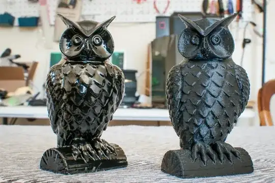

Acetone can be used to smooth ABS.
enter image description here The left has been smoothed by an acetone bath and the right is the original model. (Image credit: Andrew Sink)
Take note: acetone is dangerous to breathe in, so work in a well ventilated area. It is also flammable.
