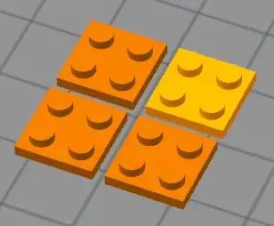

I am wondering - of course if the 3D printer's bed big enough - printing multiple copies of the same print could save me significant amount of time in a small production line, excluding minor wastage such as setup time, post-processing time, etc.
e.g. if my foo print takes 10 hours, printing 2x copies at the same time would take 2x times more, increasing linearly or it would be significantly less?

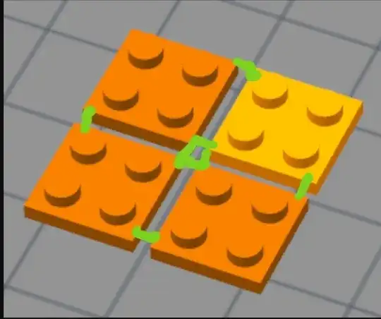

Actually the answer is yes and no. So I had to print 12 of the same small objects for a science experiment. Just some rocks I made from domes with some displaced faces, anyway my printers minimum wall width is 0.5 mm. The objects were 2 cm³. The first print failed because of them being disconnected but then I connected the 12 items by 1×1×5 mm solidified cylinders in blender and ran it through my cutter and it printed no problem. Afterwards I jusy clipped off the cylinder and was good to go. Just make sure you're object is connected at every point facing another. Based on your picture it should be connected something like this:
