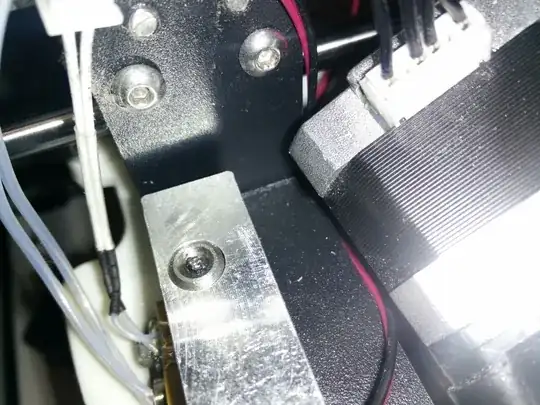

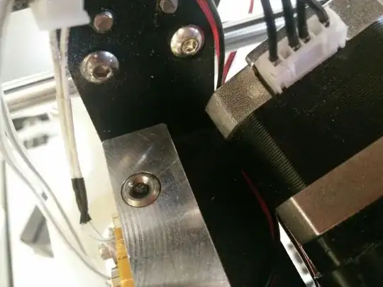

My extruder got clogged: I noticed that it wasn't extruding, so I stopped my print, removed the fan, heatsink and the extruder motor and I saw that the clog is at the heater block level.
This is a what I have:
Blocked extruder - no flash
Blocked extruder - flash
As you can see, there is some PLA clogged at the very beginning of the 1.75mm hole in the extruder block.
I can see there is something white inside (a stone? something that is not PLA?). I tried to heat up the extruder to 250°C and pushing with an hex tool but the block did not move.
I solved a lot of clogged nozzle issues with the cold pull method, it always worked like a charm, this time I tried too but as a result the PLA filament broke and the "stone" is still there.
Does anyone know if there is a way to unclog the extruder in this situation?
Do I have to change it?

I'm sure this is not the best solution, and if you have some ethyl acetate you should try that before going "the hard way".
Ethyl acetate is a solvent for PLA, so if you soak the extruder into it PLA should melt and free the extruder.
That said, this is the "hard" solution that worked for me.
You'll need:
  1. A drill
  2. A 1mm drill bit
  3. A 1.5mm drill bit
Insert the 1mm drill bit into the drill. If your drill has a setting to reduce the drilling speed, take this to the minimum speed. If your drill doesn't have such options, you'll need to push the drill button very gently.
Put the drill bit on the pla block (be sure to not touch the cooling block, you might ruin it). Start drilling at the minimum speed and push very gently, until you get a side-to-side hole on the PLA (you know it because you feel no resistance at all while pushing the drill).
Take the 1.5mm drill bit and repeat the same operation. At this point my PLA block literally exploded (now I have some broken PLA inside my room, don't know where) and the extruder was finally free.
I hope this helps someone. Please notice that you need to be very gentle in order to avoid breaking parts of your extruder, but if I managed to do it, you can do it too ;)
As previously said, if you have ethyl acetate try soaking the extruder into it to make PLA dissolve before trying this. Try this solution only if all other options didn't help.
