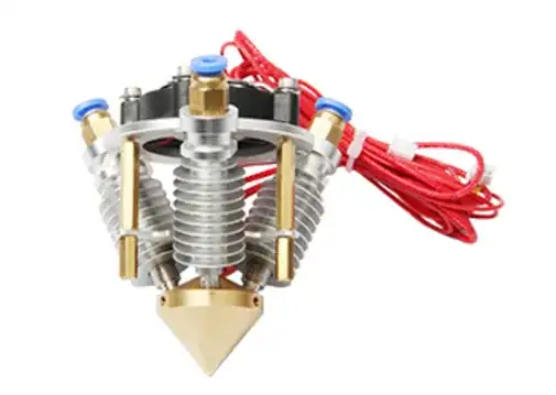

Assembly:
The printer being a kit came with the print head completely assembled as shown in the picture. Printer Head-hotend

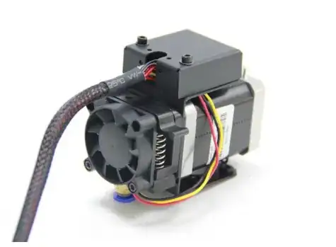

Not shown in the picture it also had the Bowden tubes in place. It also came with the extruder assembled as shown in the picture. The extruder
So aside from wiring and mounting these pieces the only thing I did was cut a clean edge on the Bowden tube and connect that to the extruder.
