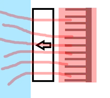

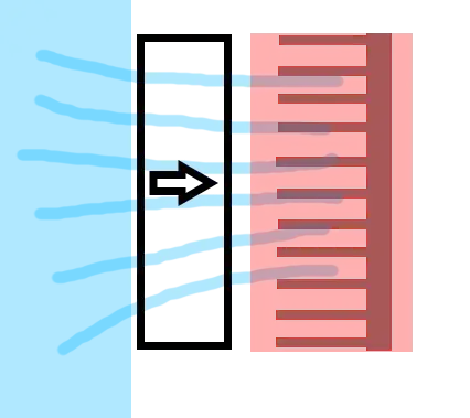

In the case of 3D Printing, it's going to be faster to cool the radiator by blowing out the heat from the source.
The idea is that you're trying to get rid of as much heat as possible in the quickest means possible. By blowing away from the radiator, you're allowing the ambient temperature to cool the hot air being blown out.
If you were to blow the ambient air towards the radiator, the blown air will warm slightly as it is overwhelmed by the heat of the radiator. Even though the ambient air may be cooler, it will take more time to cool off the radiator.
Example of bad airflow, which will take much longer to cool the radiator: enter image description here
Example of good airflow, allowing the hot air to be quickly cooled by the ambient temperature of the build space: enter image description here
