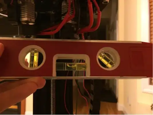

  2. Use a bubble level to get the nozzles about right. Move your z-axis up a bit and put a bubble level against the nozzles. Adjust as necessary so it's exactly level. The nozzles should be level enough that the bubble stays in the middle.

Leveling with a bubble:
Almost level, sorry for the bad lighting
