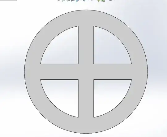

I'd suggest creating a hollow tube with ~1 to 1.5 mm walls. Then to increase the strength design your own internal structure rather than relying on the slicer to fill the part. This takes longer to model but you can design the strength of your part much better.
Something like this Cross Section
If you were to then print this with 60 % infill you'll have the strength and also use less material. If you happen to know specifically how your part would be loaded, you could then change the dimensions on that internal cross structure to take the loads better.

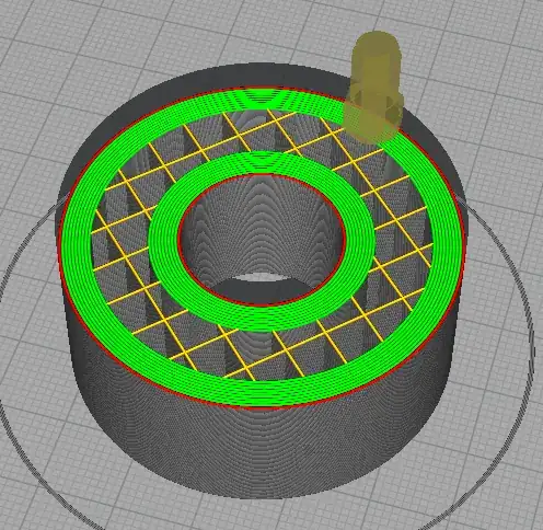

I believe the solution is to use more walls in Cura.
Here is a 50mm cylinder with a 20mm hole. I specified 10 walls in Cura.
This should give extra plastic for the screw to bit into, but not take all day to print!
