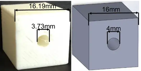

What you want to do next is to print out a few test items and see for yourself. Below is an example of reality vs. expectation. As you can see the circle shrinks. It will never expand. So you will always make it bigger than you need. It is also good to note in this example below that the block itself is Larger than expected. The best solution is to not expect high tolerances and build a lot of flex into your designs.
Example of thermal expansion

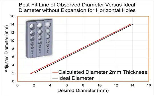

The best thing you can do is print out a tray and document how different the sizes are. Also, do the same with a print of various peg sizes. Below is an example of such a tray.
Example of a print of various holes
Images taken from this link, The Innovation Station - Tips for Designing 3D Printed Parts.
