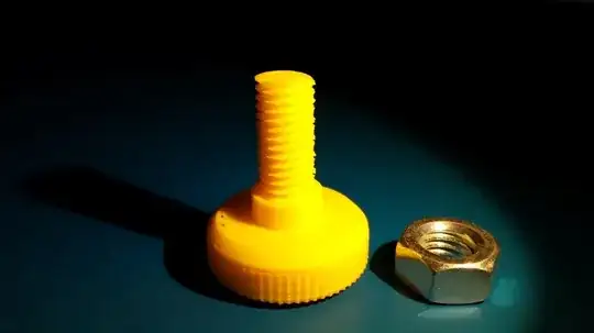

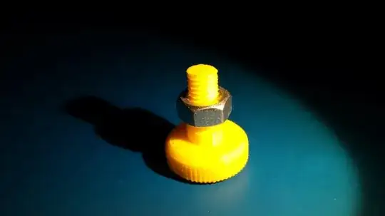

well... it's hard to imagine printing M3 or even M4 I haven't try but I haven't because I'm pretty sure it's not possible (on my printer of course)
but some time ago I've tried M8 which is of course way from your needs it was printed on 0.1mm layer height
it went ok into the nut without any problems but the strength is not very high I suppose
I know the quality is poor but even such bad photo shows issues

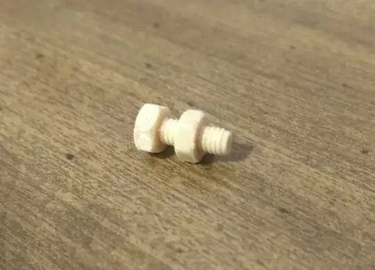

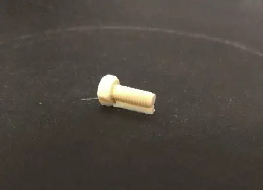

Yes. This question and most of the answers are old, and 3D printing has come a long way in the past 4 years or so. Alexandre Strube's bumping with one up-to-date answer inspired me to take another try at it, and my first attempt was an overwhelming success.
  • Bolt printed in horizontal orientation (with support), nut vertical.
  • Wall line width reduced from 0.4 mm to 0.3 mm (still 0.4 mm nozzle) - most important for the bolt or the thread profile is not achievable.
  • Layer height 0.12 for bolt, 0.08 for nut (to give nearly 10 layer per revolution)
  • Both offset 0.045 mm from ideal thread profile (at M6-M8 this is about the maximum allowable by ISO standard; at M4 it's surely excess but extrusion roundness of FDM probably compensates entirely anyway).
  • 100% infill, achieved with high wall line count rather than zigzag fill
The nut and bolt fit tightly but can be turned by hand (if your fingers are small enough) with some force.
bolt on bed with support
nut and bolt threaded together
These were printed in cheap PLA on an Ender 3 with entirely stock hardware, but upgraded controller board (SKR mini E3 V2.0) and firmware (presently using Klipper).
As for whether they're usable, My Tech Fun has a video testing the strength of 3D-printed bolts in different orientations. His tests were of M10, but the horizontally-printed one was able to hold over 140 kg in a pulling test, making it (especially with multiple bolts) suitable for serious applications.

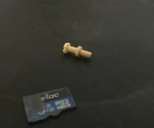

Since the question mentioned M3, I went back later and figured I'd go even smaller and give M2.5 a try... and it worked! This is pretty surprising considering the pitch is just over the nozzle size, but with 0.2 mm extrusion widths and 0.08 mm layers it came out usable:
M2.5 nut and bolt with micro sd card for scale

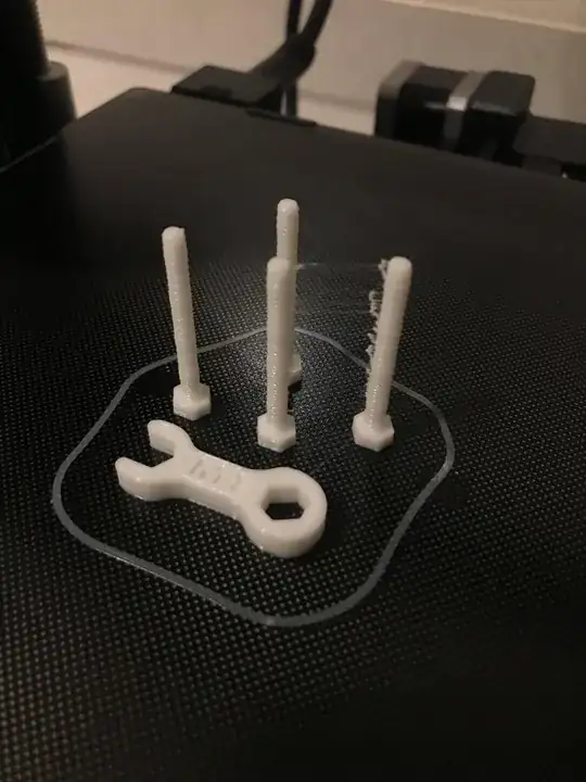

I just did.
I printed a 4 screws at .2mm and 20% infill. surprisingly, all screws worked with a plastic m4 nut I had from china (not 3d printed). The project itself 1 tells to print at 100% and 0.1.
When I started screwing the 4th one, I pushed the tool badly, and the screw head popped off.
After reading this thread, and experiencing what I just said above about the screw's head, I'm printing one more, this time at the maximum resolution and maximum infill. I'm also printing a nut to compare to this.
Even the ones with plastic flying around them worked well (see picture).
1 https://www.thingiverse.com/thing:2591857
Ps: apparently the person can't make hexagons. I will redo the heads in proper hexagons, as well as the little wrench when I have time.
