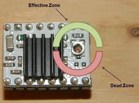

You don't say which controller board you are using, but regardless, there should be an adjustable potentiometer on the board, next to each of the stepper drivers, or on the stepper driver daughter boards. Like so,
Photo of the adjustable potentiometer
This potentiomenter adjusts the reference voltage used to control the stepper motor. From this reference voltage, and the resistance of the stepper coils, one can determine the current, which is used to drive the stepper motor.
For the stepper driver of the extruder, you could try turning this adjustable potentiometer slightly, in order to provide more current to the stepper, in turn to provide sufficient torque such that the motor is able to turn. Or, less current to stop the stepper from overheating.
The adjustments can be made whilst the power is on, but a non-ferrous (i..e. plastic) screw driver should be used, so as to avoid short circuits. Also care needs to be taken, when turning the potentiometer, as they have been known to just fall apart whilst being turned. If you are paranoid, then make micro adjustments with the power turned off, and then turn back on to check the behaviour.
Note: it should go without saying that one should never disconnect a stepper whilst the power is on, as both the driver and the stepper motor may be irrevocably damaged.
The photo above is taken from POTs Calibration – RAMPS 1.4.
If a POT is set too high then the associated stepper driver will tend to overheat and go into over-temperature thermal shutdown (to prevent damage to its components). The first sign of overheating is erratic stepper motor behavior. Typically, this can be recognized by the sounds of the stepper motor suddenly losing power (thermal shutdown). If no load or movement is required of the motor, it is hard to detect whether it is over-powered as the driver is barely producing any heat.
