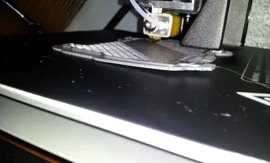

I am new to 3D printing. I thought that the black surface of my print bed was supposed to keep things stuck without additional tape, spray, etc. However, every time I print something, this same corner, and only this corner, detaches.
Any advice on how to fix this?
  • Monoprice Makerselect V2
  • Hatchbox PLA
  • Temp 195/50
Photo of print warping in corner

This is very likely caused by an uneven bed. It's probably lower in that particular corner: the nozzle is further from the bed, so the filament isn't squished down as much and therefore releases more easily from the bed.
Your bed should have 3 or 4 screws that you can adjust, you should loosen the screw in the corner that is giving you trouble.
