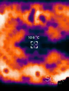

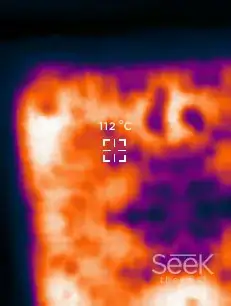

Update: Build Plate Thermal Images w/plate set @ 115C
Center Plate Front Corner
