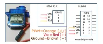

I have only installed the hardware for now (5 V servo) connected to Ext. 3 (EXP3):
  • Pin 2 (+5V);
  • Pin 4 (GND), and;
  • Pin 6 (PWM),
Servo and RAMPS 1.4 and RUMBA connections
RUMBA EXP3 pinout
but I cannot move it with the G-code command M280 P0 S180. I have no idea where to put my hands on firmware to get this going. However my ultimate goal is to set the ABL.

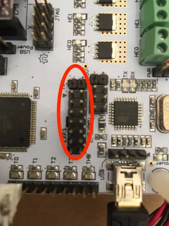

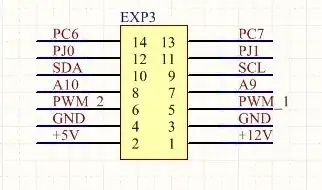

My issue about the servo not moving was caused by a wiring mistake. The Exp. 3 has 14 pins has per this diagram.
However when phisically looking at the board, what you see is this: enter image description here
I took the first 2 pins on the right of such connector and the 3rd one of the first row thinking that I was connecting pins 2-4-5 of Exp. 3. I was wrong, because the first 2 (1-2) pins are not part of Exp. 3.

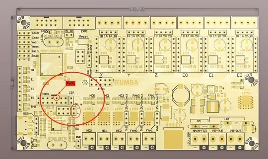

The right way to connect the servo is as following: enter image description here
Then use PWM1 (pin 5 Ext.3) I decided to leave trace of this issue and the relevant solution for someone that may experience the same issue.
