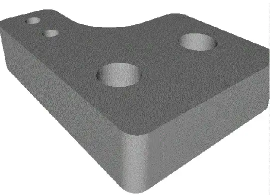

I had a problem with my Z limit switch bracket falling just short of the bottom edge of the z stage.
I'm trying to make the bracket thicker so it's pushed more towards the left.
1) how do I measure the thickness of the bracket in the stl 2) HOw would I make it thicker if it is indeed too thin
It's might to be mounted standing up right.
I want to make it thicker x axis (if it's stood up)
Ageis

Please provide an image of the model and an indication of the portion you wish to increase.
EDIT after photo and some clarification. Your last line has valuable information. Thicker x axis if it's stood up implies thicker z axis in photo. That's the easiest location for that model. It would take me about 30 seconds to stretch it in Meshmixer. If you attempted it yourself, it might take you two or three minutes.
