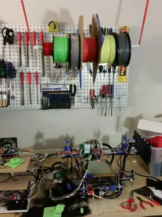

Here's my current setup for reference (filament removed): enter image description here

When I first set up my printer, the spool was able to spin freely. Filament was making loose coils on the outer layer of the spool. Snags happened frequently. I decided that not allowing the spool to spin faster than the rate draw of the filament might improve the way the filament was feeding.
I put more physical distance between the spool and the machine. The filament stopped bunching up in loose coils on the surface of the spool, and the snags went away. The increased amount of slack between the machine and the spool seemed to absorb the "overshoot" of the filament draw and the spools became much better behaved. I also was able to run the spool down to the end more consistently than before.
Not everyone has extra room to use, and not all extruders are conveniently oriented, so moving the spool further away from the machine won't work for everyone. I believe a guide or some sort of dampener would serve the same function, if the underlying problem is the spool loosening up enough to where loops of filament get caught under others and then snag. What worked for me was to stop the spool from "racing ahead" of the rate of draw and loosening up enough to snag.

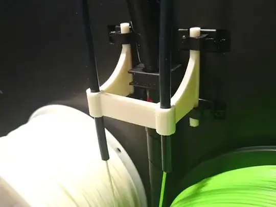

Though not technically tangled your filament can also get stuck if the spool does not properly unwind (and the filament gets wrapped around the axle that supports your spool). Make sure your spool can rotate on its holder easily (ball bearings are not needed, a simple round axle is enough). Make sure that your printer pulls on the middle of the spool, and not sideways. If necessary, could build a guide (such as a small ring or tube for the filament to pass through) to keep it centered.

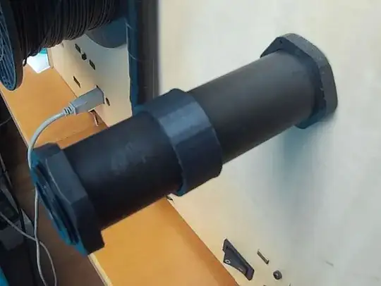

I had the same problem with my FFC dual.
Consider using some kind of retaing clip to hold the spool in place, so it doesn't move back and forth on the post. This spool holder worked for me:
Another thing that can help is to make sure you are pulling the filament from the middle of the spool. This worked for me:
