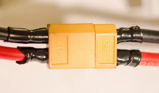

You might be able to use one of the connectors (Deans Ultra, EC3, XT-60/30, Bullet) that are normally used for RC models. They're made for very high currents. The XT60 connectors depicted below are rated for 60A continuous (well above what you'd need for any heated bed); their smaller XT30 cousins are good for 30A but less commonly available.
XT60 Connector (Photo by Mark Fickett)
