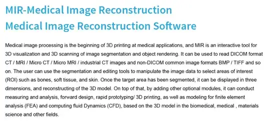

This software may be of some use to you.
Whilst looking into software/firmware for a Frankensbox FX-800, I came across this document For medical use - Dedicated series 3D printer, on the Dedibot website, which on page 4 states the following:
MIR - scanned text
The relevant part (in text form) is this:
It can be used to read DICOM format CT/MRI/Micro CT/Micro MRI/Industrial CT images and non-DICOM common image formats BMP/TIFF and so on.
