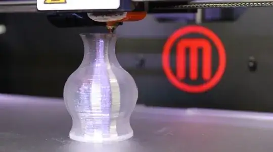

So you want a translucent case which can hide the LEDs when they are off, but show then when they are on? I agree this might not be the best fabrication method for this effect. I would print a case with a window and use a tinted laser cut plexi glass. That said, it wouldn't be that hard.

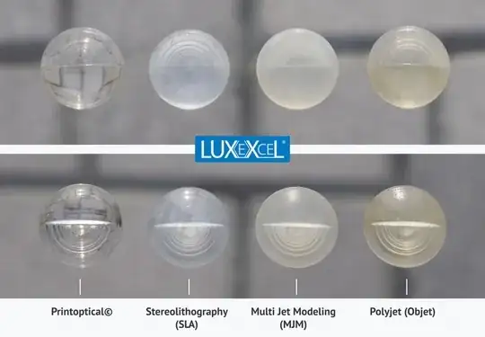

Example of resin and other clear prints
There are a few catches. First you will have 3d printing texture. The lines and ribs. So there will be light distortion. However it can be minimized by either using a resin 3d printer with ultra high quality, or by having the window side printed on the bed, avoiding the ribbing. Albeit it is still not perfect.

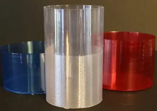

Sample of FDM with high diffusion of light
I would look at translucent materials such as Tglass. Using these clear materials you can either ally a window tinting yourself or find a seller that has a very dark, yet still clear material. This will allow the effect where a LED is off and you cannot see it, and when it is on - see it.

There are other options such as Resins, clear ABS, and PolyCarb (high temp)
