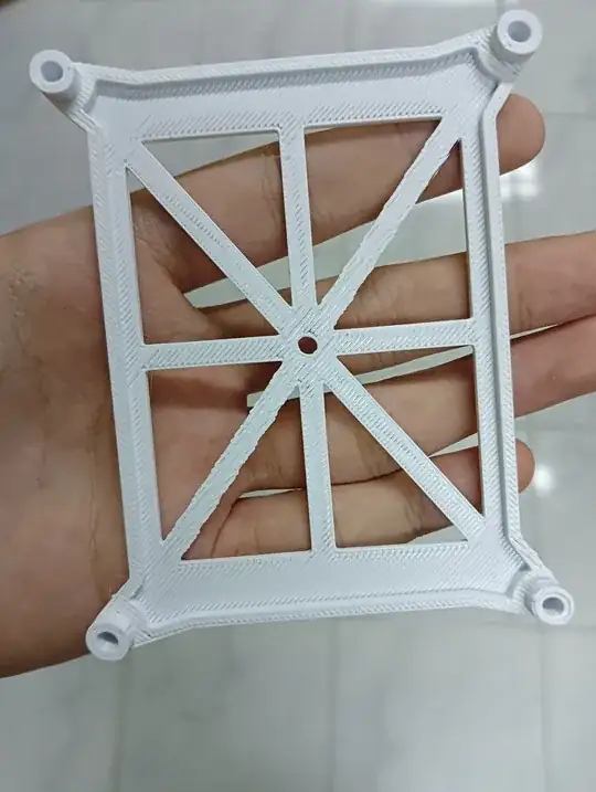

I've had five Creality K1C CoreXY 3D printers for about four months. Recently, one of them started having issues where the printed holes aren't coming out as circles and the parts aren't accurate. I'm using the same G-code that works perfectly on my other K1C printers, where the holes print as they should. I've attached some pictures for comparison. I haven't found anyone with a similar issue yet, so any help is appreciated. If you think a calibration model would help diagnose the issue, feel free to suggest one and I'll print it. I'll send you pictures of the results.

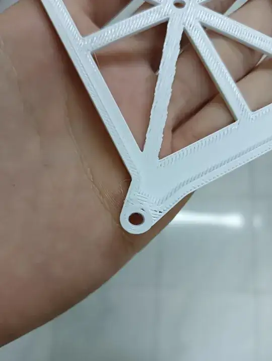

A portion of a 3D printed model showing an oval opening that should be circular
Photo of a complete 3D printed model with 5 oval openings

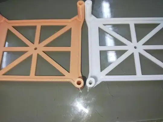

Photo of two 3D printed models a peach-colored model with its holes circular and a white model with its holes oval

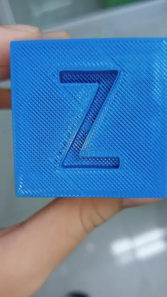

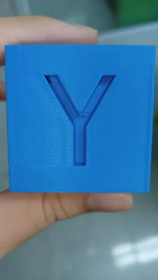

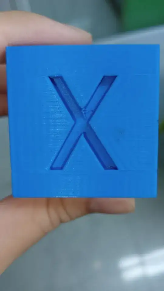

calibrate cube 40mm x side calibrate cube 40mm y side calibrate cube 40mm z side
