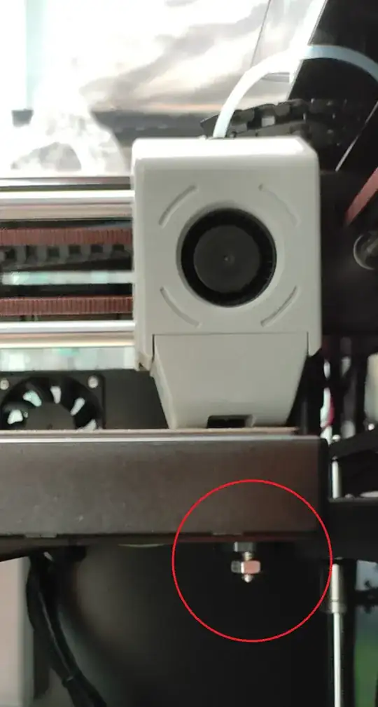

No matter how I twist and turn the knob, the height of the bed doesn't seem to changeI am here to seek your guidance on two issues regarding my Qidi Q1 Pro printer.
Firstly, I am looking into replacing a missing component that is essential for adjusting the height of the printing bed on my printer. Despite my attempts to adjust it following the provided instructions, the bed height remains unchanged. As a newcomer to the world of 3D printing, I am considering sourcing this replacement part externally. Can someone provides me with the specifications of the missing component (is this a spring that missing?) and offer instructions on how to properly install it?

To answer your first question: The QIDI Q1 pro has auto bed leveling, so I assume that the bed height is compensated by the bed probe.
