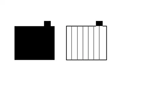

My son is printing a simple block with a small (2 mm high) bump on top - see image below of the cross section. The left shows the 3D model and the right shows where the plastic actually prints, using a grid infill at around 10 %, with a top height of 1.6 mm
Grapic of a block with a square bump on top; a cross section of the block is next to the first
As you can see, this is very weak, and the bump very easily snaps off, as it has very little plastic securing it to the layer below. When we increase the top/bottom thickness (in Creality Cloud) to 4 mm this issue goes away, and the bumps are well connected. But then the print takes a very long time.

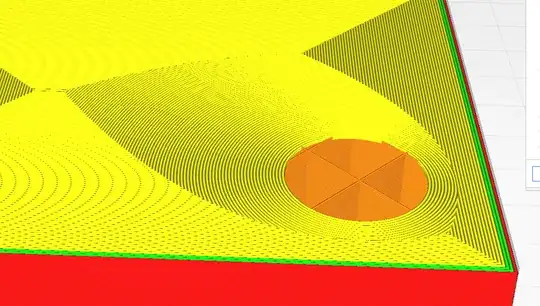

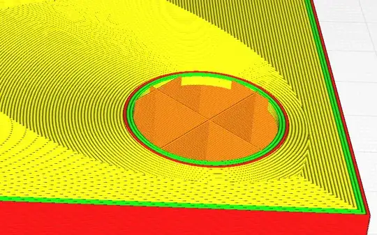

Putting it into the slicer, and looking at the first layer of the top, you will see that there is a an empty hole that has the diameter of the nub's outer diameter minus the wall thickness, where only the infill is. A little bit further up, one layer over the top layer, it's easy to see that the whole nub is resting on just its wall, which is filled under it.
enter image description hereenter image description here
This means, the contact area between the nub and block is very limited: it's only the walls, and a little bit of squishy infill.

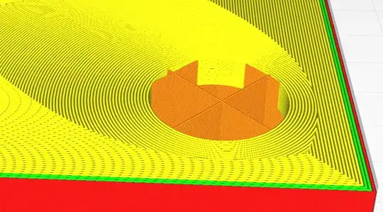

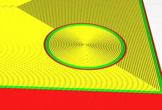

Why does it work with super thick top layers?
Remember what I said earlier about contact area of the nub to the nub? If the nub is lower than the height of the number of top layers specified, the whole nub is solid, and any top layers that are still remaining get resolved to completing the top layer of the block. From the bottom there still is a bore, but the interface between the nub and the block is over the full area of the print. As adhesion goes with the contact area, that means the nub is more resiliant.
But as you print much more plastic, you also print much longer.
