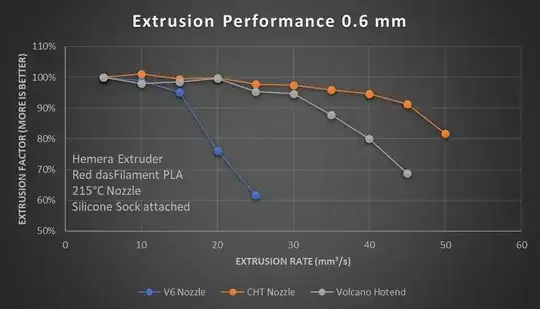

CNC Kitchen tested the performance with the following results:
Extrusion Performance 0.6 mm V6 vs CHT nozzle vs Volcano

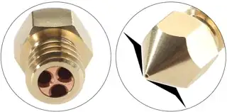

Image of a typical cloned MK8 CHT nozzle:
Image of an original E3D v6 CHT nozzle:
Do note the quality differences, the original are superior machines apposed to the clones, look at the pattern of the inner 3 bore holes, the original is much closer together so that the filament flows directly into the 3 holes (almost 1 big hole in fact) whereas for the clones the 3 bore holes are apart causing the filament to hit a wall (center piece) and needs to be diverted to the outer 3 holes.

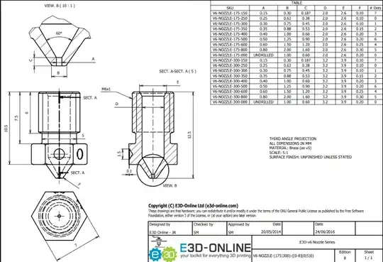

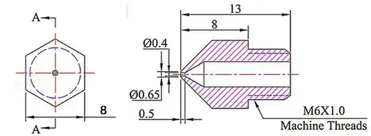

Looking at the dimensions below, you see that the threads are identical (both M6x1), but the overall length is 0.5 mm shorter for the E3D v6, so this should match. This reference tells us that the nozzles are interchangeable:
For the [Creality] MK8 nozzle, it [red. i.e. the E3D v6 nozzle] will be compatible with 3D printers that use [Creality] MK8 hotends. [Creality] MK8 nozzles are incompatible with the V6 ecosystem.
The E3D v6 will work on the MK8 because they are longer from the threads to the base of the hexagonal nut, therefore MK8 will not work in an E3D v6 hotend, they are too short. You cannot screw in the MK8 far enough into E3D v6 far enough, the base of the hexagonal nut will touch the heater block and leaves a space between the nozzle and the heat break. If these aren't sufficiently tightened together, the heat block may leak and the cavity is detrimental for retraction performance.
Information on the dimension of the different nozzles
Creality MK8 dimensions: enter image description here
E3D v6 dimensions: enter image description here

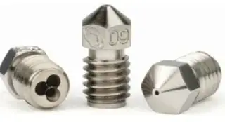

Bondtech sells genuine CHT in both Creality MK8 and e3D V6 forms. If you prefer matching what your machine has exactly, you can buy that, but it will only work on the Creality-style "MK8" hotends, not anything else. If you buy the e3D V6 version, it will work on your Ender's Creality MK8 hotend and any hotend that's compatible with e3D V6 nozzles.
I've always bought the e3D V6 version for my Ender and it's worked fine.
