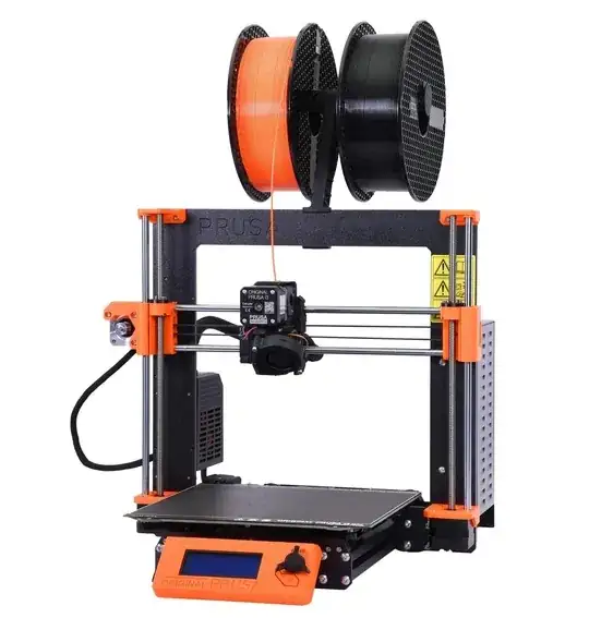

It depends on your printer really. If you have a direct drive printer with all metal hotend, then you can feed filament directly into the carriage without any guiding tubes.
For example, the Prusa i3 models (MK3, MK3.9, MK4) don't require any tubes, as shown in Prusa's own promotional photos:
Edit: It seems this is misleading marketing, as there is apparently ~5cm of PTFE internal to the carriage.
Prusa i3 MK3 printer with a spool of filament above it, the filament fed directly into the top of the X carriage
As for replacing a Bowden tube with something other than PTFE... I don't know any of concrete examples of a proven solution, but really any tube in which you can easily slide your filaments (i.e. low friction) will do.
