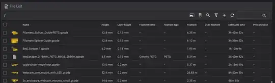

I've been using Klipper and Cura for a while now (somewhat new to 3D printing), and I notice whenever I import a new G-code file to Klipper, none of the Slicer settings from Cura display in the G-code files in Klipper. However, when I imported a G-code file from my friend (the PETG one) I noticed it showed up right away:
Screenshot of the File List from the web interface for klipper

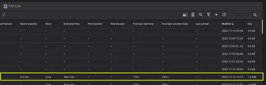

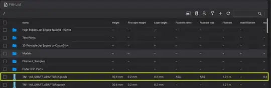

And it works fine in MoonRaker as well
Screenshot of the left-hand portion of MoonRaker's File List
Screenshot of the right-hand portion of MoonRaker's File List
