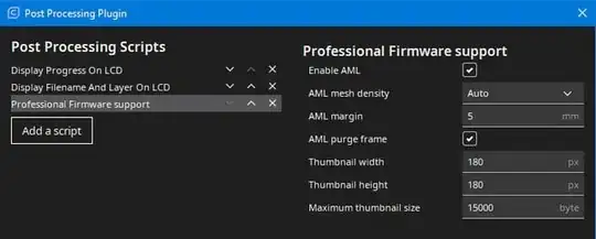

Below is a screenshot of how the Cura Plugin shows AML options:
Cura Post Processing Plugin - Professional Firmware Support
I have successfully tested AML and I think it's a truly transformative and great way to do fast and more precise bed leveling, only to the relevant print areas on the bed. Also, while probing, the screen shows each probing point in real time being filled in a grid.
