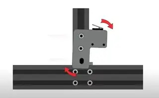

It sounds to me like your end-stops positions relative to your new bed level are off or the Z-offset is very off, did you use microsteps and manually checked the Z-offset?
The nozzle crashing into the bed is kind of catastrophic, the bed is maybe much higher than the current end-stops. Could that be the case?
Ender 3 V2 endstops
Make sure that the end-stops are high enough to prevent the nozzle from being below bed level and preventing physical damage to the bed. Also make sure that your end-stops are tightly connected to the frame, unable to move to avoid further offsetting issues such as:
Ender 3 V2 endstop movement
As explained in this YouTube video.
