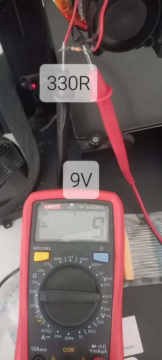

After encountering issues with an unknown brand fan overpowering the Creality fan, I experimented with resistors. Initially, a 330-ohm resistor resolved the thermal runaway warning but led to under-extrusion due to inadequate cooling.

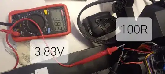

A 100-ohm resistor addressed under-extrusion but triggered thermal runaway. enter image description here

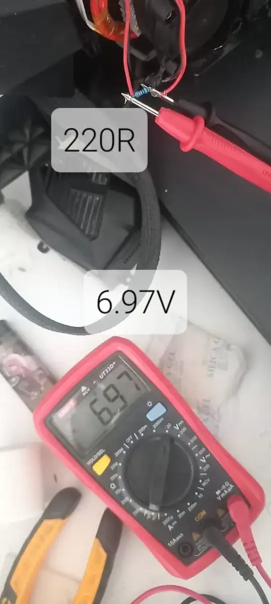

The optimal solution was a 220-ohm resistor, resolving both issues. enter image description here
I've tested this setup for approximately 1 day, 11 hours, and 7 minutes with successful results.
