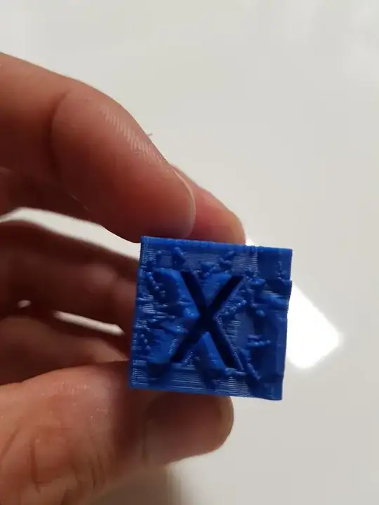

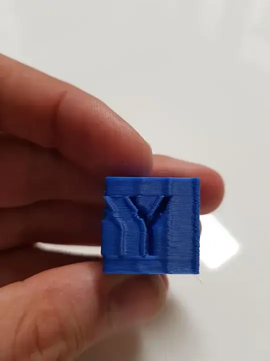

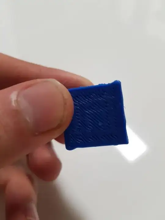

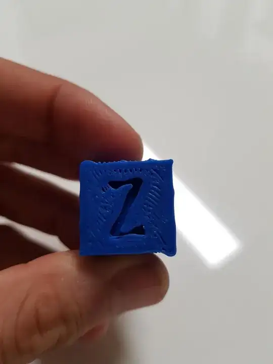

Being a newbie in 3D printing, I have some trouble with my prints. After removing wiggle room from the X axis and the bed, there are deformities even on simple prints. The first layer turns out okay-ish but there seems to be some stringing that makes the print deviate consisently when there is a turn. How could I improve? My setup:
Ender 3 V2 - stock printing bed, extruder/nozzles
Firmware: mriscoc
Auto bed leveling (BL touch) - Z offset -2.18mm
Slicer: Cura - 0.2mm layers, 20% infill
Material: PLA - 200C nozzle, 60C printing bed.
The Gcode of the XYZ cube:

Sample output (XYZ cube):
X face
Y face
Z face
Side view

Update: I identified the issue as a lack of tension in the X and Y timing belts. After tightening the belts, the prints are much smoother !
