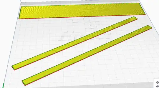

You can see the problem below: enter image description here As you see, the long rectangle on the bottom is getting cut off when printed. Outline shown in red shows the path the printer is really taking. (you can ignore the gray area, it is only there because both long rectangles are part of the same .stl file)

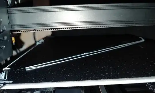

Here is another view of the sliced print: enter image description here
Additionally, you can see in this other picture: enter image description here
  • The print started quite a bit from the left edge
  • The start G-code, which prints lines on the left, printed lines closer to the left edge than where the print started

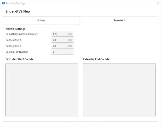

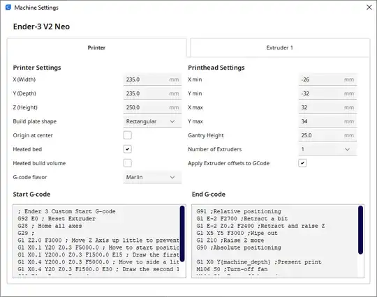

Slicer settings: enter image description here enter image description here
How can I fix this? Is this due to the slicer? Due to the firmware? In either case, how do I change it?

If I look at the printed middle rectangle, it appears that the printer is printing way too far to the right, or, your slicer used an incorrect bed size.
You should look into question How to center my prints on the build platform? (Re-calibrate homing offset) or Recalibrating Home-position to center the print area and try to re-print the object again. Furthermore, as far as can be interpreted from the low res images, your printer may need some better leveling as some parts are too high and some too low.

Your firmware and slicer operate on different sizes.
You need to update the firmware to update the bed size (and the 0-Offset) from the factory setting to the actual size. There is no way to alter the Maximum sizes via a direct connection.
