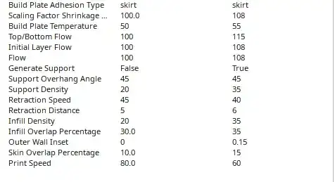

I'm trying to print white PLA at 200ºC with the following Cura settings on an Ender 5 Pro:

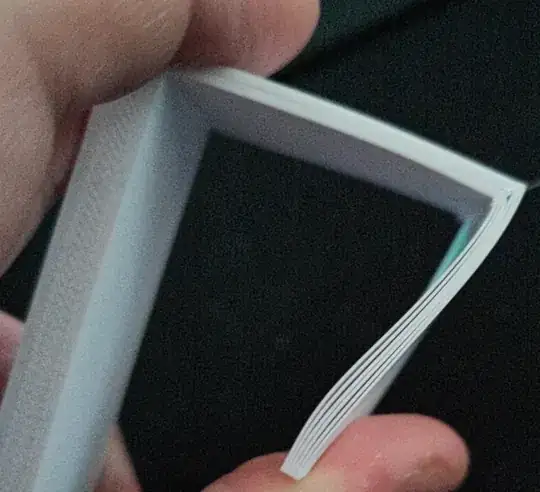

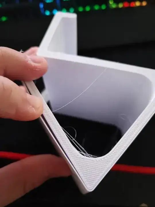

Here's the result:
I've tampered with my settings a bit, but still, it doesn't seem to make any difference. I'm pretty convinced it's a setting issue... Any idea?

From the print effects I do reckon that you are printing your model with a line width of 0.4 mm from a 0.4 mm nozzle. Due to the physical properties of different filaments, this can result in lines that are actually more narrow than demanded, resulting in delamination of walls like shown.
To work against all those problems, it is usually best to demand the printer to print lines about 10 % wider than the nozzle, e.g. 0.45 mm.
