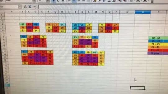

Here are measurements from an infrared thermometer:
temp in °C in different measurements
I kept the orientation and distance constant.
