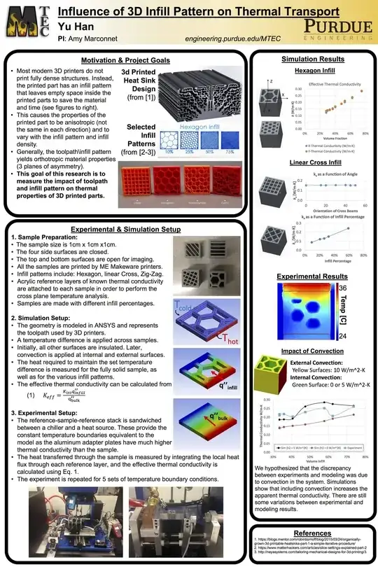

I don't have the answers, but I did just come across this useful poster presentation on the same topic: Influence of 3D infill pattern on thermal transport, by Yu Han
It may provide some help.
