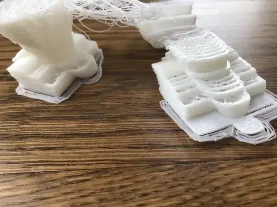

I have recently purchased an Anycubic Kobra, and the first two prints worked out fine. On the third print, the Y-axis belt snapped, so I contacted Anycubic support and they gave me a replacement one. I did a few test owl prints, but there was major Y-axis shifting on the prints.
Images of two failed owl prints
After I replaced the belt, I made sure that they were as tight as possible, but there was some slack, but I couldn't tighten them further. There is only shifting in the Y-axis, but it mostly only shifts in one direction (towards front).
What other reasons would cause a Y-axis shift like this? Is this due to incorrect belt replacement, as there was no shifting prior to the belt snap?

I found a solution to this layer shifting. Even though the belt was too loose, I managed to use a rubber band to tighten the belt slightly. Now to prints go off without a hitch. Thanks for your help.
