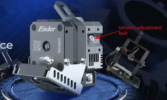

This is the Creality Sprite Extruder Pro.
The tension is controlled by a bolt with a square-shaped nut that is pressing on the lever with a spring. To increase tension to the gears that feed the filament the adjustment bolt is turned clockwise.
However, you have to be very careful not to turn it too far, or the bolt will unhook from the internal nut. Turning anti-clockwise in this situation does nothing.
If you're lucky, like I was, it will get stuck in a position of max tension no matter what you do. If unlucky, the various parts can go into the gears and cause permanent damage.
It is a most unfortunate design as there is no way to tell if you turned it too far!
In my case, having it at max tension at all times caused it to under-extrude. Adding more flow alleviated the problem somewhat. I had to open everything up to see what was going on there. In my case, just putting the nut back on the bolt solved my problem.
TPU is much softer than PLA so it's more sensitive to tension. While PLA can print okay at max tension, TPU cannot.
Tension adjustment bolt
