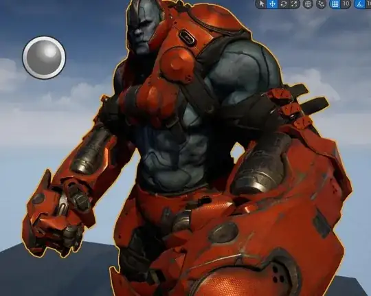

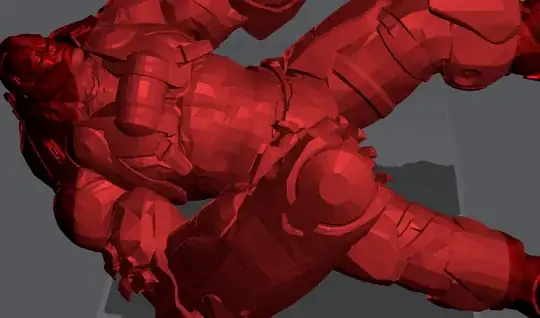

I wanted to experiment with a 3D printer and downloaded Lychee Slicer and wanted to print an Unreal asset. I took a free one from the store and exported the static mesh as .obj, so I can load it in Lychee. The only thing is details and curves have disappeared and smooth surfaces are visible polygons. Is this something that can be fixed?
Screenshot of a 3D model in Unreal Engine
Screenshot of a 3D model in Lychee Slicer

The curves (simple smoothing or real "multiple-per-vertex-normals") are embedded in the vertex information of the model and probably still exist in the obj. Lychee only sees the real 3D polygon mesh and discards the vertex data. Your best way to add some sort of polygon smoothing like MeshSmooth or TurboSmooth in 3ds Max, Maya, or Blender. It will read the vertex info and apply it to the mesh, thus creating more vertices. See the following YouTube video for an example:
