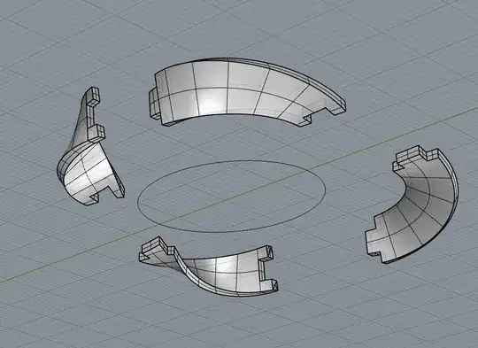

I'm a beginner with OpenSCAD. I use to work with Rhino, but I have no more license and the new Fablab I'm working with uses OpenSCAD, so I'm learning OpenSCAD now.
The picture below shows what I want to do, I need this to be able to 3D print several parts to get a larger Möbius strip.
3D rendering of a Möbius strip broken into four interlocking pieces

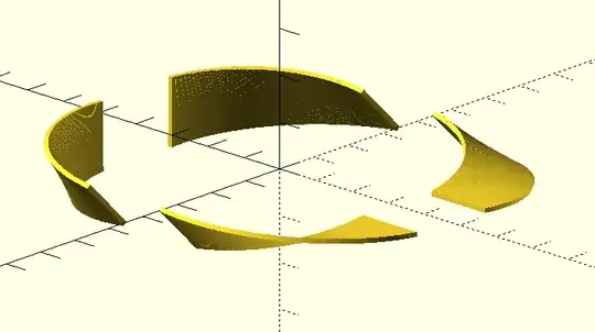

Cutting to pieces
To cut the ring into pieces you can take the intersection() of the object and the quadrant of interest (e.g. using a cube, but a wedge would have worked as well).
 * Möbius Strip
 * r: radius of strip
 * w: width of strip
 * t: thickness of strip
 * The model uses $fs to adjust the smoothness.
module moebius_strip(r = 1, w = 1, t = 1) {
    step = $fs;
    for(azimuth = [0 : step : 360]) {
        x = r * cos(azimuth);
        y = r * sin(azimuth);
        translate([x, y, 0]) {
            rotate([0, azimuth/2, azimuth]) {
                cube([t, step, w], center=true);
$fs = 0.5;
xloc=[0,1,-1,-1,1]; yloc=[0,1,1,-1,-1]; //quadrant = 4; // 1, 2, 3 or 4 for(quadrant = [1 : 1 : 4]) intersection(){ translate([xloc[quadrant]10,yloc[quadrant]10,0]) moebius_strip(r = 30, w = 15, t = 1); translate([xloc[quadrant]10,yloc[quadrant]10,-(30+15/2)/2]) rotate([0,0,(quadrant-1)*90]) cube(30+15/2); }
Ring cut in quarts, display with offset

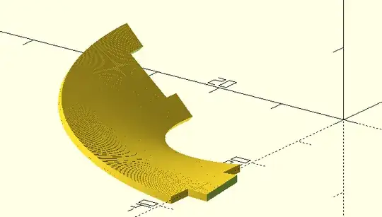

Since tabs and slots are requested, we need to make some adjustments.
Add/subtract tabs to piece
All that is left to do is to cutout a "rectangular" shape at the interfaces. For that we glue or union() a tab on one side and extrude or difference() a tab on the other side, a wedge is used for the intersection() with a smaller sized width Mobius strip.
echo(version=version());
//debug = 0;
//explode = $preview ? 0.1 : 0.0;
//$fn = $preview ? 90 : 360;
//nearly_zero = $preview ? 0.005: 0.0;
tol = 0.01;
 * Möbius Strip
 * w: width of strip
step = $preview ? 2 : 0.5;
module wedge(h,r,a) { th=(a%360)/2; difference() { cylinder(h=h,r=r,center=true); if(th<90) { for(n=[-1,1])rotate(-thn)translate([(r+0.5)n,0,0]) cube(size=[r2+1,r2+1,h+1],center=true); } else { intersection() { rotate(-th)translate([(r+0.5),(r+0.5),0]) cube(size=[r2+1,r2+1,h+1],center=true); rotate(th)translate([-(r+0.5),(r+0.5),0]) cube(size=[r2+1,r2+1,h+1],center=true); } } } }
xloc=[0,1,-1,-1, 1]; // vector indexed by the quadrant, negative value is the negative x-axis yloc=[0,1, 1,-1,-1]; // vector indexed by the quadrant, negative value is the negative y-axis offsetVal=0; // can be used to explode the view quadrant = 1; // 1, 2, 3 or 4 resp. for xy, -xy, -x-y or x-y //for(quadrant = [1 : 1 : 4]){ // now commented to used single single quadrant difference(){ // for extruding the tab union(){ // for adding the tab intersection(){ translate([xloc[quadrant]offsetVal,yloc[quadrant]offsetVal,0]) moebius_strip(r = 30, w = 15, t = 1); // Mobius belt translate([xloc[quadrant]offsetVal,yloc[quadrant]offsetVal,-(30+15/2)/2]) rotate([0,0,(quadrant-1)*90]) cube(30+15/2); // quadrant cube } intersection(){ moebius_strip(r = 30, w = 7.5, t = 1); // Mobius belt with smaller width rotate([0,0,(quadrant-1)*90]){ wedge((30+15/2), (30+15/2), 10); // intersect with wedge to get a tab that extends the quadrant piece } } } intersection(){ moebius_strip(r = 30, w = 7.5, t = 1+tol); // Mobius belt with smaller width and increased thickness for better cutting out negative tab rotate([0,0,(quadrant-2)*90]){ wedge((30+15/2), (30+15/2), 10); // intersect with wedge to get a tab that extrudes the quadrant piece } } } //}

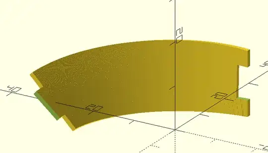

Quadrant 1 piece with tabs
Note that this takes some time to render (F6), the preview (F5) didn't even show because of too much elements. Just change the value of quadrant = 1; to 2, 3 or 4 for the other segments.
Quadrant 2 piece with tabs

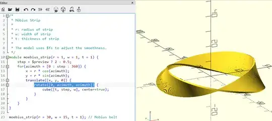

Please note that the image from the question is not what is created with the Mobius script, to generate that object rotate([0, azimuth/2, azimuth]) needs to be changed to rotate([0, azimuth, azimuth])
