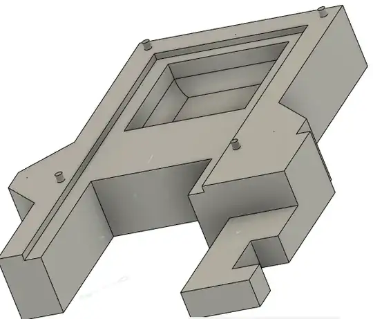

When designing for 3d FDM printing, I'm wondering what is best practice for items with large overhangs which cannot have (or would be fairly impractical) support structures. Consider my following design:
This item is about 7" long, and you'll notice the narrow slot running through the middle of it. The slot is 0.100" wide.
I was about to print this when I suddenly realized printing it would be a problem. So I started messing around with painting on supports, but since something slides in this slot, I would have to do some extensive cleanup to make sure it's smooth.
What I ended up doing was splitting the body at the start of the overhang, and placing some alignment pins in the body (with corresponding holes in the upper portion of the body. e.g.
I will print the top and bottom separately and glue them together.
My question is whether this is my only option or if I'm missing something in the design process which might work better? This design is in Fusion360, in case that matters when discussing some specific tools that are available which I'm unaware of.
LarryBud
  • 288
When constructing a model intended to be 3D printed, your approach is sound. Overhangs and the required supports can be a severe problem and I believe your assessment is accurate.
The complexity of the upper portion would make printed supports an inappropriate path for the reasons you've provided, while your solution eliminates all the negative aspects of this model's construction/design.
The split as presented turns an excessively supported print into two completely unsupported, easily-printed sections. The alignment pins are the perfect approach as well.
You've not indicated an aversion to adhesive, another plus in the overall assessment. Printing the model(s) in the orientation displayed is going to provide the most strength from the plastic. In some models, one can change the orientation to eliminate or reduce supports, but too often the layer direction change results in a weaker object. Your split design removes that factor as well.

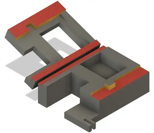

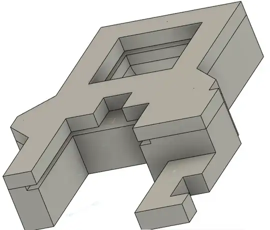

While slicing into slabs and the use of alignment pins is a perfectly viable solution, including the alignment features organically into a single print can make assembly faster. In this case, the model itself acts as an alignment feature or might even act as the clamp, at the cost of creating a more complex cut. An additional benefit of a more complex cut is the elimination of separate alignment pins and getting the glue surfaces away from parts that need a critical dimension
As an example, I used an approximation of your model and shifted the cut layer around some (more complex) to get a natural left-right alignment feature from the deep cut, and then added a high "peak" on the model to act as a front-back alignment feature. The yellow faces ensure alignment in this case, and the red faces are main glue faces.

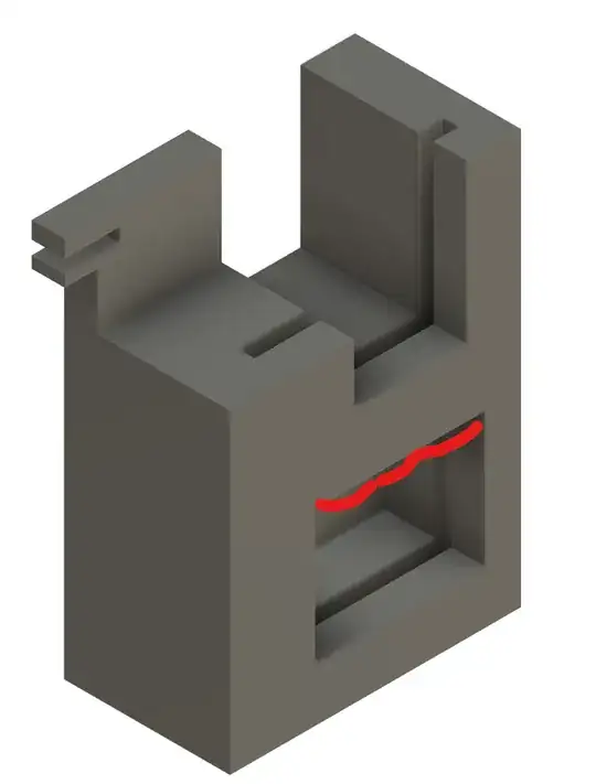

Also, keep in mind point orientation can alter things a lot: printing on the "back" as we both modeled, the slot needs support. However, there is an orientation that remove the need to support the slot's top and instead only requires support in the pocket, possibly eliminating the need for a two-part print at the cost of needing to remove the support in the area marked red, but which, as a pocket without undercuts, should be decently easy:
