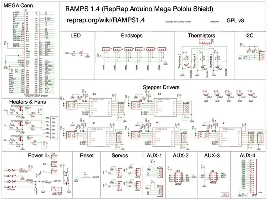

Another (more logical) approach would be to look at the schematic of the RAMPS to follow the circuits connected to the contacts that you shorted. Then check the components along that path. This method often is the most fruitful.
Assuming that you have a RAMPS 1.4 (you don't specify which version you have), there is the schematic:
RAMPS 1.4 schematic
