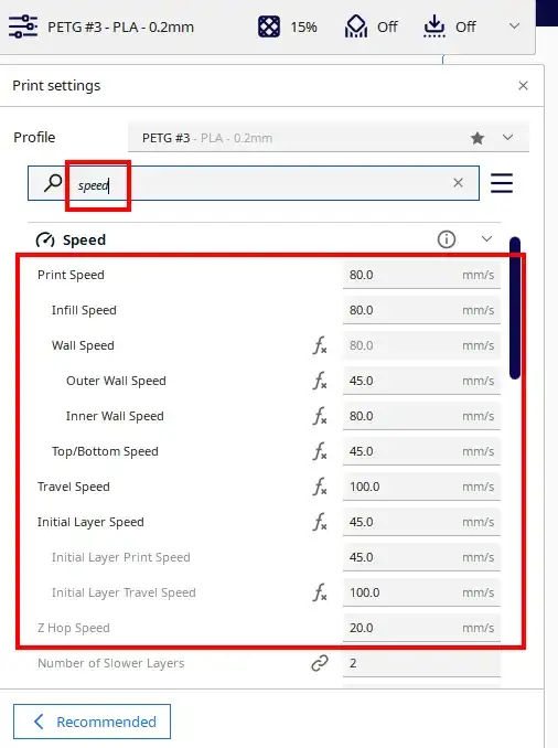

In a review for a certain filament I read that somebody recommended "a feeding rate of 105%".
What does he mean, and how could I set this in Cura?
When I search for "feed" in the print settings properties of Cura, nothing is found, so I suspect he means "speed".
When I search for speed, multiple speed settings turn up, not only one.
How could I do what he recommended?
Thank you!
